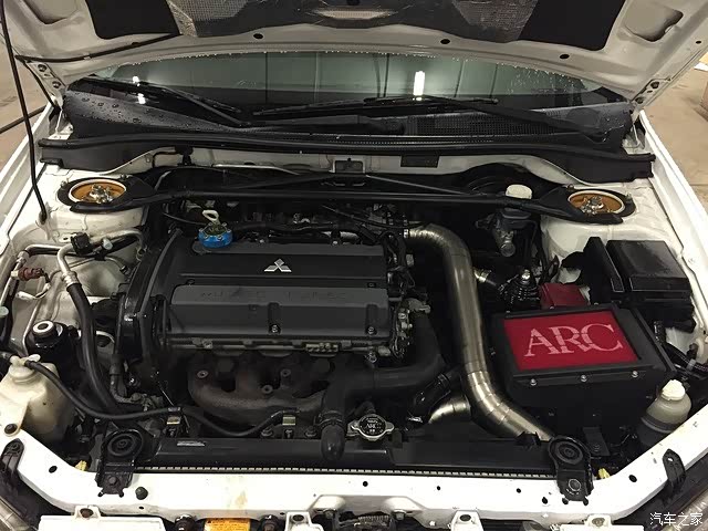

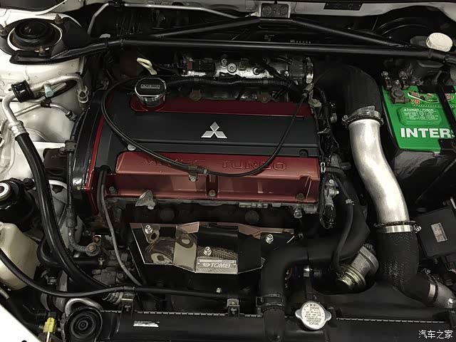

改装清单:
Engine/Cooling
- Stock Block
- ARP Head Studs
- Tomei 270 Poncam Type-R
- SpoolinUp COP
- WORKS High Pressure TB Shaft Seals
- Origin Fabrication Slim Radiator
- SPAL Slim Fan
- Origin Fabrication-spec Setrab Oil Cooler kit
Turbo/Exhaust System
- Borg Warner EFR 7163 .80 A/R Twinscroll
- Turbosmart 23psi Wga
- Full-Race Bottom Mount Manifold
- Origin Fabrication Inconel 625 3" Downpipe
- Origin Fabrication Aluminum Wiggins SD Intake/Airbox + Blitz SUS Filter
- Origin Fabrication Aluminum Wiggins Charge Piping
- Hypertune "Race Core" Intercooler
- Tomei Expreme Ti cat-back + Origin Fabrication 3" V-Band Flange Conversion
Drivetrain
- Stock Trans/T-Case
- TRE Rear Diff
- English Racing ACD Tune
- Exedy HD Twin Disc + ACT Monoloc
Tuning/Fueling
- AEM Infinity 6
- Bosch Motorsports 1050cc Injectors
- AEM 320 Fuel Pump
- Radium Fuel Rail
- MAC 3 Port Boost Control Solenoid
Suspension/Brakes/Wheels
- Rays Volk ZE40 18x9.5 +22, Bronze
- Rays Center Caps
- Project Kics R40 Lugs
- ARP Extended Studs
- 255/35 Yokohama AD08Rs
- Ohlins Road & Track Coilovers 10k/10k
- Whiteline RCK
- Torque Solutions diff mount, mustache bar & driveshaft carrier bushings
- Torque Solutions front motor mount
- Endless Racing 6/4 Inch Up Brake Kit + MX72 Pads

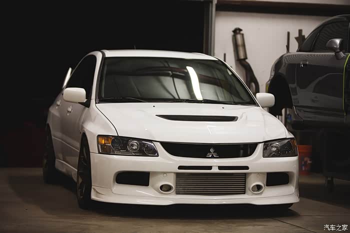

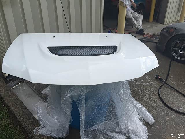

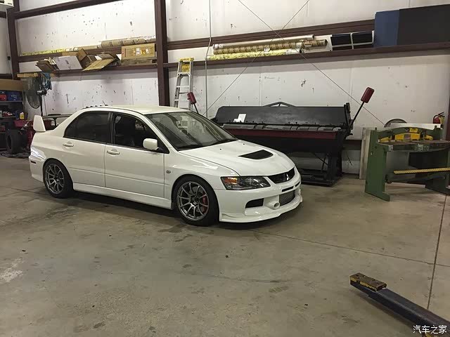

全车重新做漆,看起来和新的无异,只是动力和悬架已经满足不了自己了。改装前,素素的:

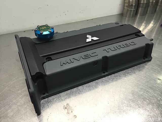

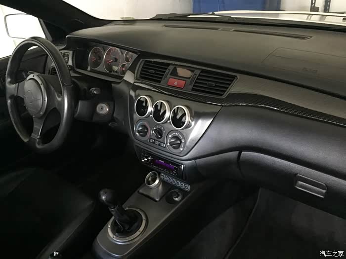

内饰保养的挺不错
有小幅度改装,基本没动硬件

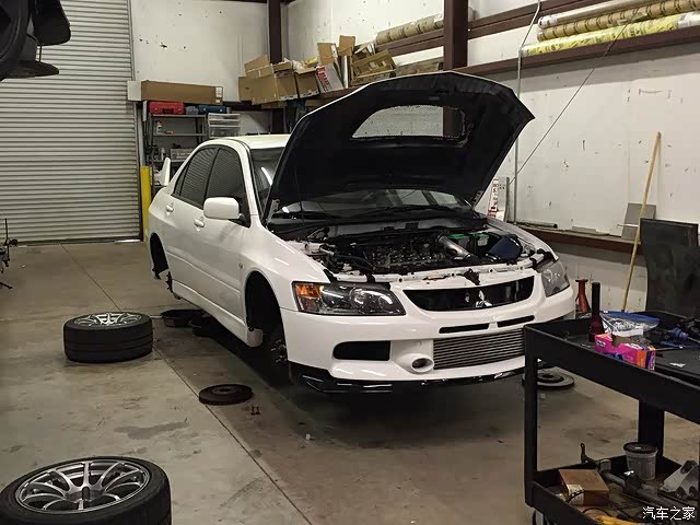

开进车间即将开始

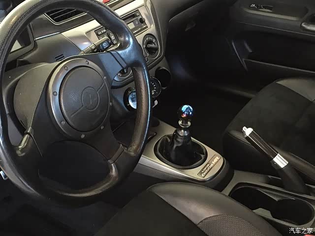

内饰小改,手刹柄上的碳纤维是贴纸

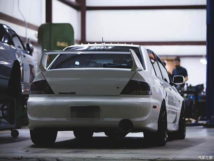

基本完毕

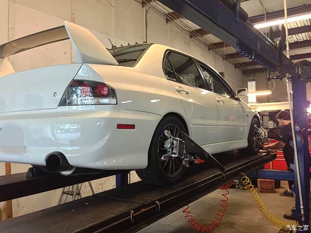

比之前还低了一点
后面的朋友摄影技术给个赞
