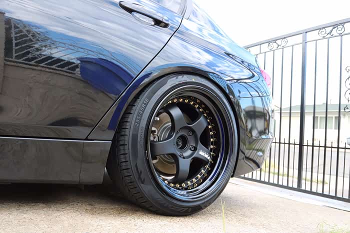

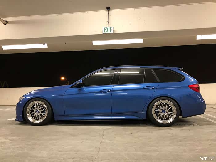

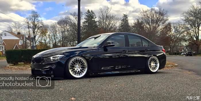

EC-7, Race Silver,
轮毂数据18x9" ET42 & 18x9.5" ET43
轮胎数据 245/40-18 & 255/40-18, Toyo & T1 Sports
悬挂 KW V3 Coilovers
前倾角 -0.7 degrees of camber up front
后倾角 -1.9 degrees of camber in rear

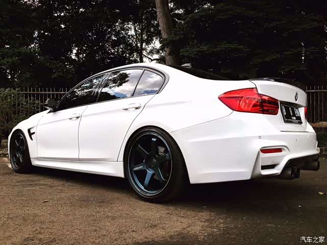

忽略品牌Satin Black EC-7
前轮轮毂数据 18'/ 8.5et35
后轮轮毂数据 19/9.5et43
轮胎数据Bridgestone Potenza RE050A 245/40 275/35
前后轮倾角数据 Dinan Springs, camber is -0.5/-1.3

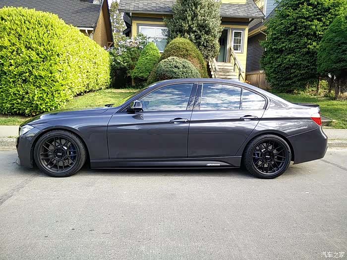

Square Setup:
前轮18x8.5" ET35
后轮 18x8.5 ET 30
SM-10 Wheels in Anthracite
轮胎数据 235/40-18 Nexen N5000 Tires
前轮数据 Wheels: 18x8.5" ET35 &
后轮数据 18x9" ET30 SM-10 wheels in Anthracite
轮胎数据Tires: Hankook RS-4 245/40/18 square
避震器 Suspension: ST-XA (KW)
刹车 Brakes: M performance brake
18x9.5" ET58 APEX ARC-8 Wheel
18x9.5" ET58 APEX EC-7 Wheel

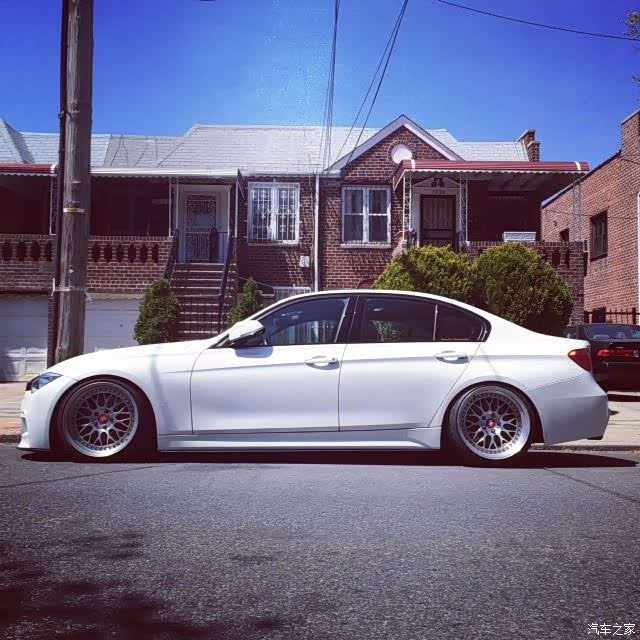

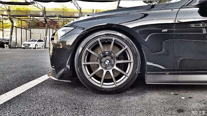

陆续更新中。
前轮18x8.5" ET35
后轮18x8.5" ET35
SM-10 wheels in Race Silver
245/40-18 Michelin Pilot Super Sports
前轮轮毂数据 19x9" ET28 ARC-8 Wheels
前轮轮胎数据 245/35-19 Hankook Tires
后轮轮毂数据19x9.5" ET33 ARC-8 Wheels
后轮轮胎数据275/30-19 Hankook Tires
前轮轮毂数据/轮胎数据
18x9" et30 FL-5 wheels
245/40-18 Hankook Ventus V12
后轮 轮毂数据/轮胎数据
18x9.5" et35 FL-5 wheels
255/40-18 Hankook Ventus V12
避震器 BC Racing Coilovers
CKS Coilovers + Swift Springs
VMR V705
VMR V721

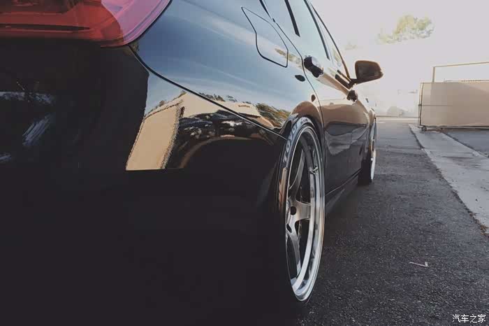

19x8.5 ET30 w/235/35/19
19x9.5 ET37 w/275/30/19
19x9.5 ET35 w/275/30/19

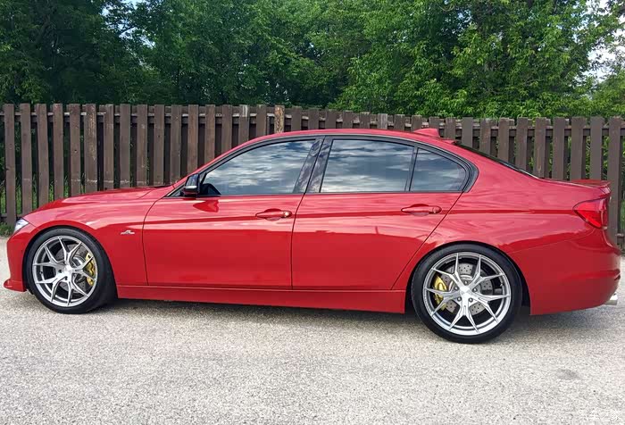

BBS LM-Rs come in 19x8.5 +32 /
19x9.5 +35
20x9 +32 // 20x10.5 +42
20x9 +32 //
20x10.5 +42
20x9 ET32
20x10.5 ET42
Front 20x8.5 5x120 +35 Pirelli PZero 245/35/20
Rear 20x10.5 5x120 +45 Pirelli PZero 275/30/20
20x9 ET30
20x11ET44

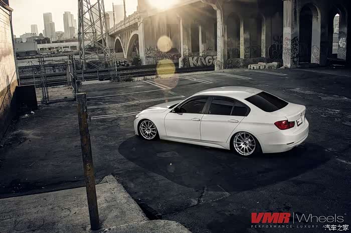

Vossen CV3
20x9 ET 35 w/245/35
20x10.5 et42 w/275/30 (-3 rear camber)
20x8.5 +32 and 20x9.5 +37
225/35/20 and 255/30/20
BBS LM 19x8.5"ET32 with 235/35R19
BBS LM 19x10" ET45 with 275/30R19

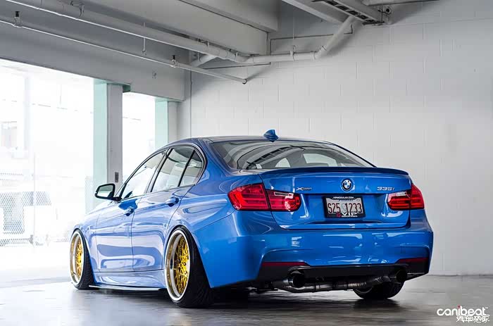

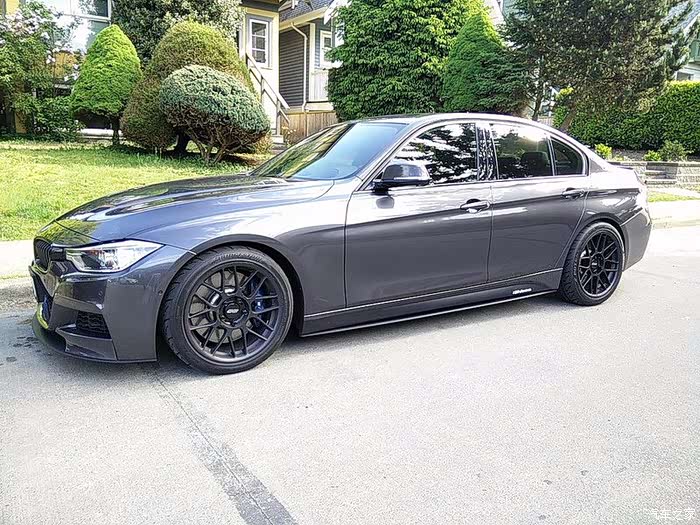

Vossen VFS2 20x9, 20x10, lowered with H&R super sport springs.
Wheels: SSR SP4's 20X9 et29 // 20X10.5 et43
Tires: Toyo T1 Sport 240/30 Front - 275/30 Rear
Wheels: SSR SP4 20X9 et29 (F) 20X10.5 et43 (R)
Tires: Toyo T1 Sport 245/30/20 (F) 275/30/20 (R)
Suspension: KW V2 Coilover
19x9.5 et25 front 225/35/19
19x10.5 et25 rear 265/30/19
New wheels 19x9 and 19x10.5
19x10 et16,
19x11.5 et28
front: 19x9.5
rear: 19x10.5
20x10 +33 20x10.5 +40 -3 camber
20" 8.5/9.5 et 36
8.5/10 et 35
Radi8 wheels. 19x8.5 19x10
Wheels are OEM 437M
19x9” et29 fronts with 235/35/19
19x10” et40 rears with 265/30/19
KW V2 Coilovers

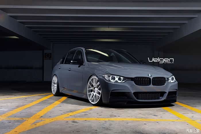

Advan RS-DF
18x8.5 +23 (with 12mm spacer, +35 originally)
18x9.5 +35
235/40/18 Falken Azenis RT 615-K
265/35/18 Falken Azenis RT 615-K
Suspension: KW V2
Tires: 245/35/19 front and 275/30/19 rear
Wheels: Signature Fully Forged Monoblock SV103 - Crystal Burgundy
Size: 19x9 ET35 front and 19x10 ET40 rear
楼上有数据

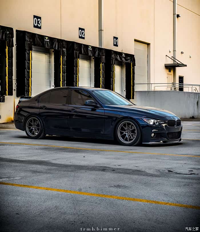

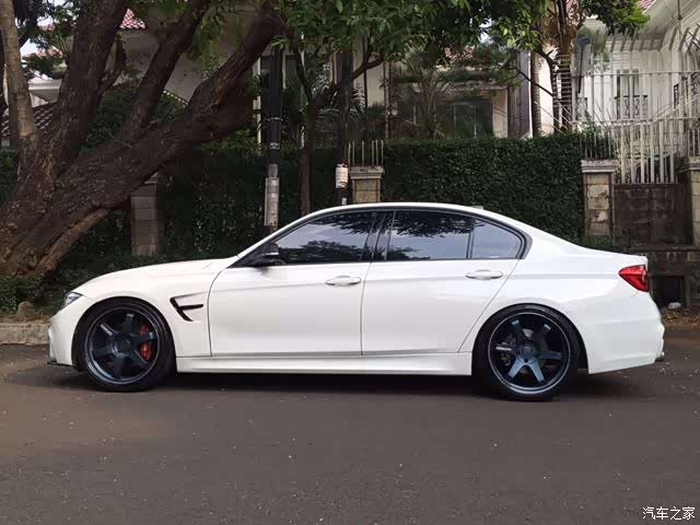

Rotiform OZT - 19x9.5/19x11
Work Meister
18x9 +18 215/45/18
18x10 +28 235/45/18
Volk Racing TE37 OG
18x9.5 +28 all around
Falken RT615k+
255/40/18 all around
Camber
Front: -2.6
Rear: -2.8
